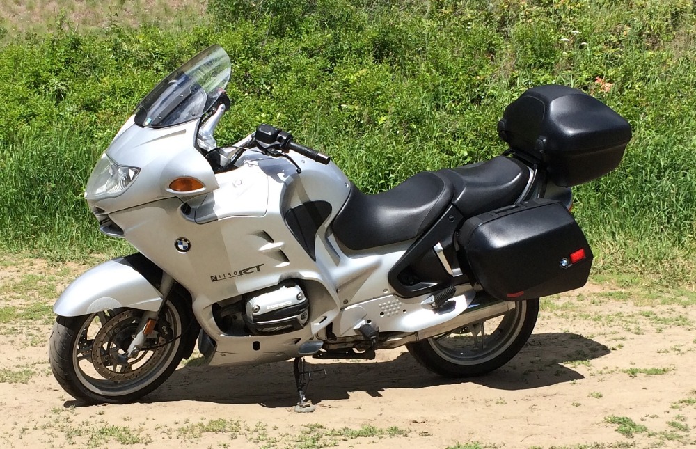

With neither rhyme nor reason, every now and then my bike dies while Shifting Gears.
Hot or Cold; 1-2 or 5-6 and everywhere else in between.
At least once a week while cruising along my bike will just loose power and "Shut Off".
Depressing the Clutch and Pushing the Start Button brings her right back to life in an instant, but still...
It's a pretty weird experience (especially at highway speeds) that never fails to get my (immediate) attention.
Any idea's what might be happening? Anyone?
