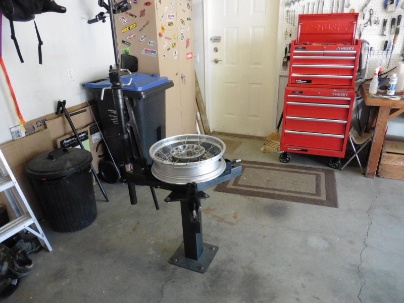

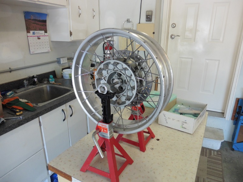

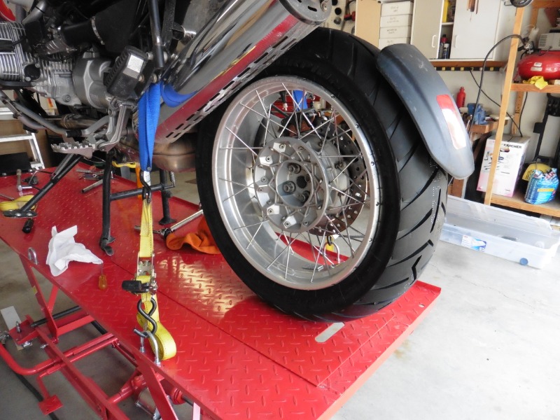

A quick run in the morning to Lordco and I've got a new set of rubber valve stems. Insert the new valve stems and a quick check on the balance without the tire. Love the Marc Parnes balancer.
Then onto the No Mar for tire installation. Rear tires on the GS can be a bit of a pain with the thick rims. I had to enlist Kathi to hold a tire iron while I spun on the tire.

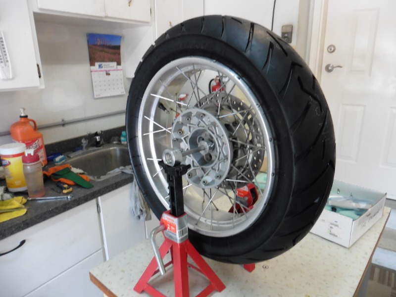

Back onto the balancer. It only required a couple of 7 gram weights to get it right.
Back on the bike and the rear is ready to go.

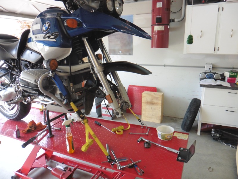

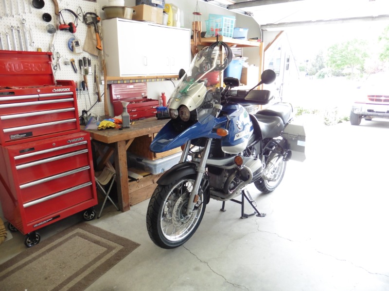

With the rear done it was time for the front tire.
Basically a repeat of the rear. Check balance with the new valve stem prior to installing the tire. Installing the front was a bit easier but I still had to enlist Kathi's help. I have a "Helping Hand" that I could normally use to hold the bead in place, but again it doesn't fit these rims. I'll have to find something that will work on these cross-spoke rims.
All back together and were good to go.

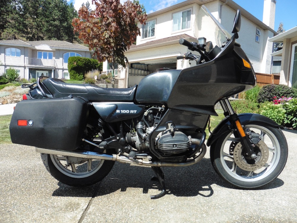

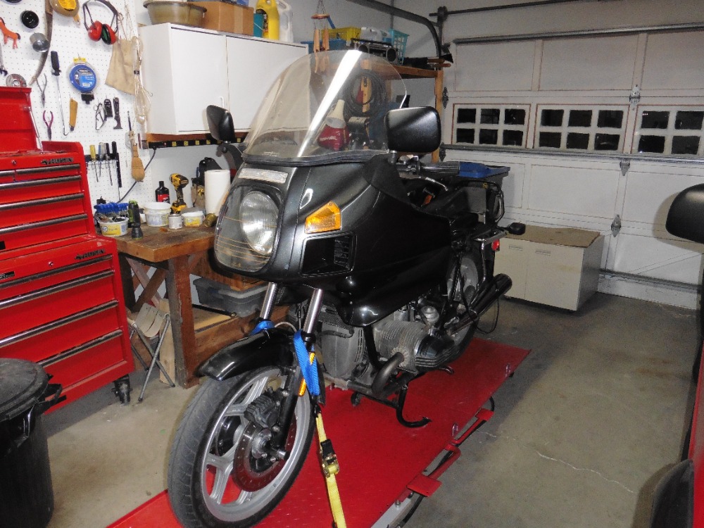

As some of you may know I jumped down the Airhead rabbit hole and purchased a 1992 R100RT in July of 2020.

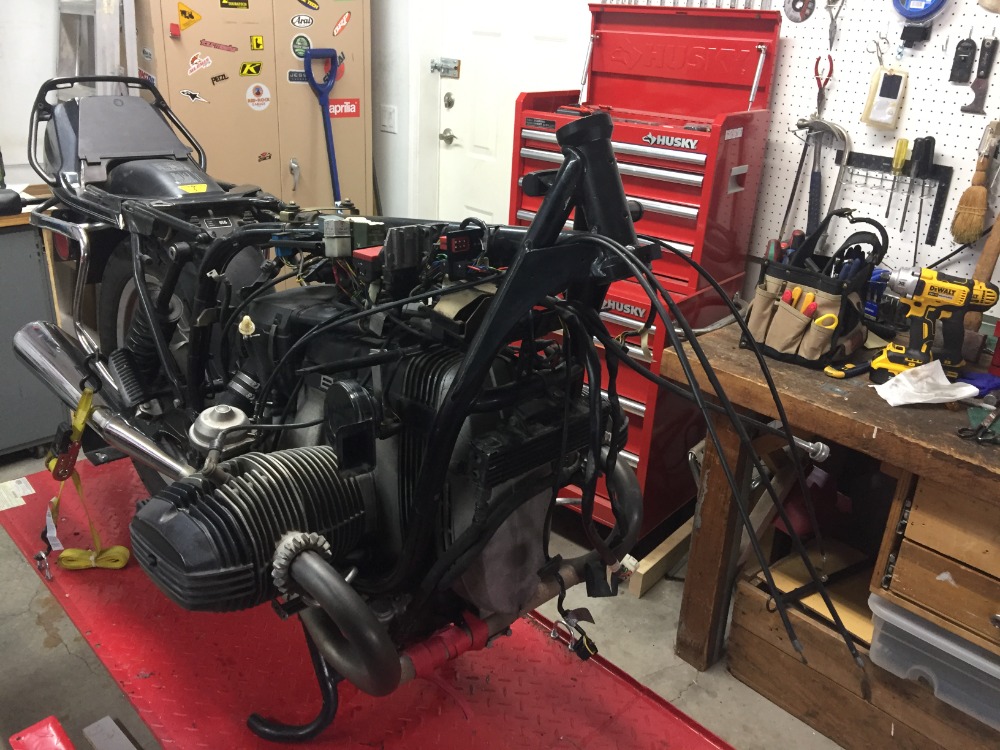

I immediately applied for my Collector plates and got them in September 2020. I knew the bike had a couple of issues, particular with the handling (It could develop a very nasty head shake) and I had every intention of going through it that winter, but life got in the way. It wasn't until October of 2021 that I finally started my project. Since the motor ran strong, it shifted well and the drive train seemed tight, I planned to concentrate on the handling. As a result I stripped the whole front end off.
The repair involved: new steering head bearings, new wheel bearings, new fork springs, rebuilding the forks, new brake lines, new tires, and a whole bunch of minor repairs to the fairing mounts.
If you're interested in reading through the whole nitty-gritty of the repair, I kept a blog on my SmugMug page so I could keep track of what I've done. You can access and read through it at this link.
waynecorley.smugmug.com/Motorcycle-Trips...-BMW-R100RT-Refresh/
The bike is currently at the stage in this photo.
I've had it out for a couple of test rides totaling around 150 km and the handling is so much better. It rides like I hoped it would. I still need to refit the fairing lowers and engine guards but I've decided that I need to do some carb work. I've ordered a carb rebuild kit as well as new floats. I plan to do a whole rebuild on the carbs. Wish me luck as I haven't dealt with carbs for a long time.

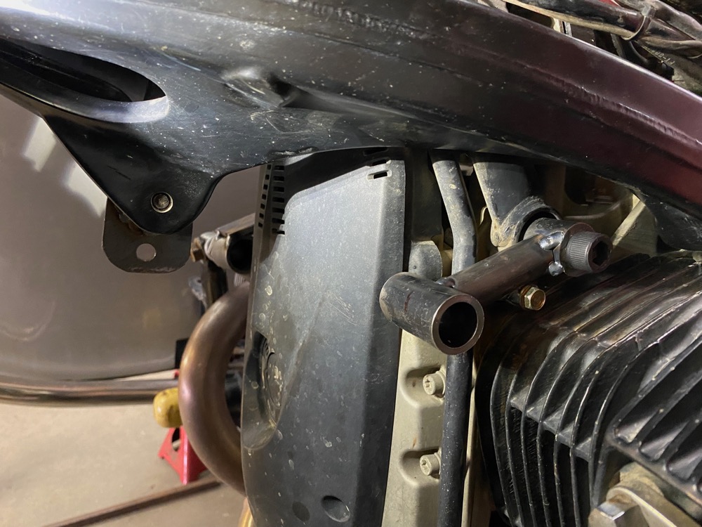

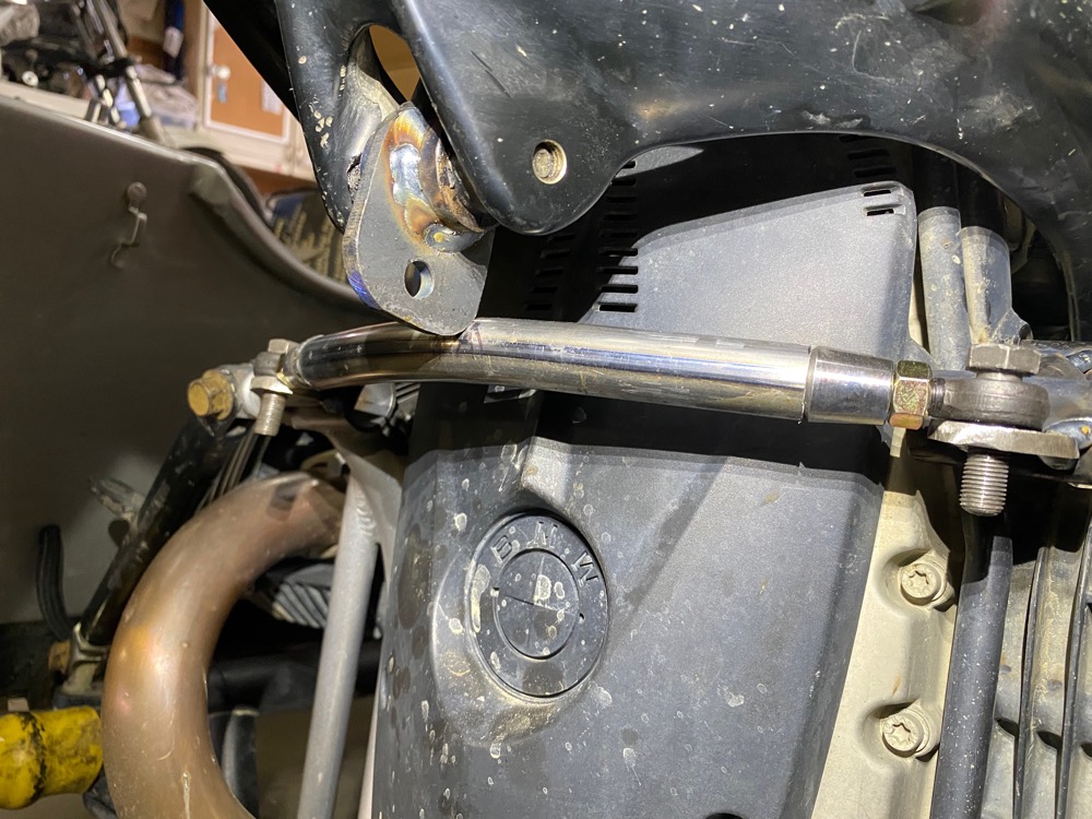

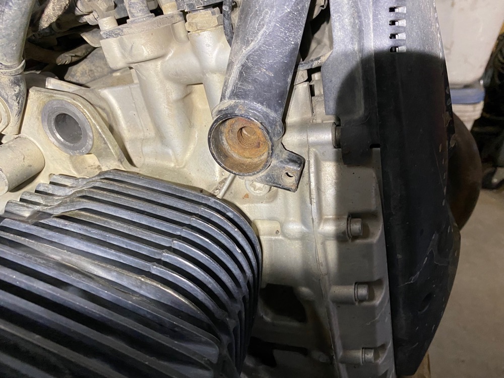

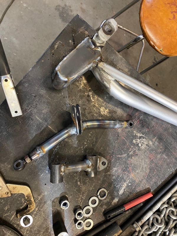

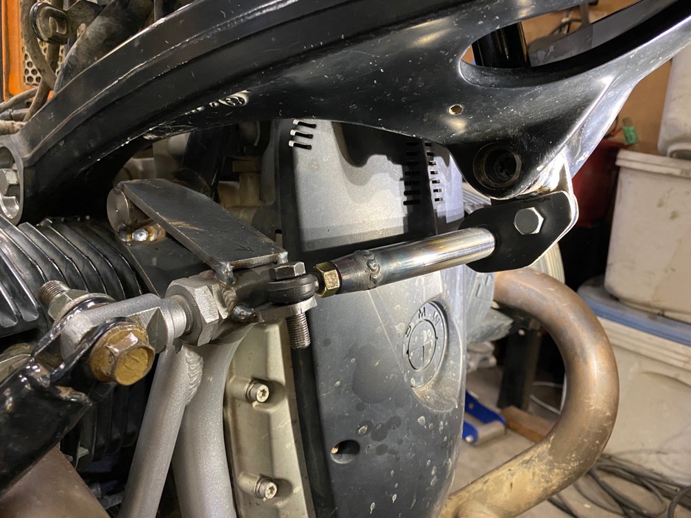

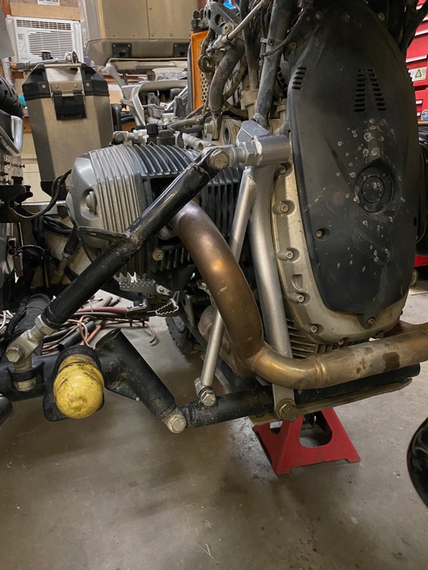

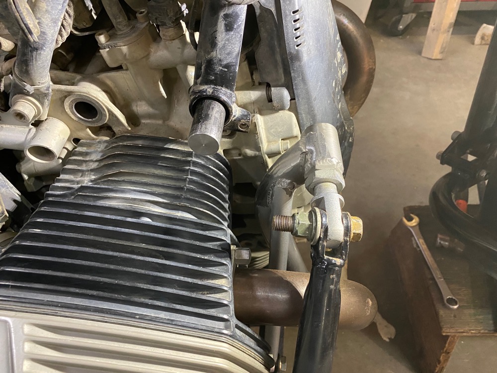

Over the last while I have had an annoying clunk on left turns with the Rig. I was determined to find and fix it this winter. I believe this may be it
I have had trouble with this mount before as it broke in the first year. More stress on it than you think

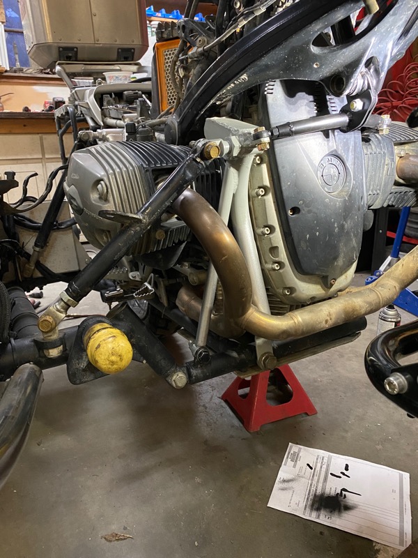

After much thinking and a few beers I had a plan
With the Mount fabrication complete I once again proved I am not a welder. HA!
Every thing assembled and it all fits. Now for Spring to really get here so I can see if that clunk is gone. Fingers Crossed
