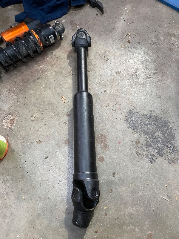

2 years 7 months ago #943
by RadioFlyer
FREE Lifetime Driveshaft Replacements was created by RadioFlyer
If you have a recent vintage (i.e. liquid cooled) R1200/1250GS you have probably heard about BMW's "service campaign" to install a duck bill valve on driveshaft housing to permit water to exit and the associated testing of driveshafts for faults with faulty driveshafts being replaced and even driveshafts over a certain mileage being replaced.
More recently with the release of the R1300GS it has come to light that its maintenance schedule calls for the lubrication of the splines every 20,000 kms and the replacement of the driveshaft at 80,000 kms. Thus the driveshaft has become a consumable item.
Coincident with this BMW decided to amend the scheduled maintenance on the liquid cooled R1200/1250 bikes to also include lubrication of the splines every 20,000 kms and to specifiy that those driveshfts are also consumable but at 60,000 kms.
Most recently a number of BMW forums in the EU have had posts claiming that BMW is now offering lifetime FREE replacement of the driveshafts on the R1200/1250 liquid cooled bikes at the aforementioned intervals. Understandably this has been greeted with some skepticism.
This development was posted on ADVRIDER here along with a link to a moto website in the Netherlands:
www.advrider.com/f/threads/drive-shaft-r...page-2#post-49128575
I reported this to a contact I have at l'association francophone des motos BMW (AFMB.BIKE) who in turn contacted the BMW factory in Berlin for confirmation.
He has reported that BMW has confirmed the reports.
BMW will offer FREE of charge mileage-based driveshaft replacement for the lifetime of the bike even if the mileage threshold is reached several times.
The measure also applies to the R and RT bikes.
Time will tell if conditions apply.

I had the rig booked in for inspection but hesitated and cancelled. I am not quite at the mileage for replacement.. Still I did my own inspection as I do all my own work. At first I thought something was wrong as being an Automotive guy the shaft is clearly not clocked correctly. But after several searches and conversations it appears as if they are all like this.
Can someone maybe explain WHY?? My whole life I have have been told it is very important to have it clocked correctly and experienced ones that are not.. BMW engineers know something different ???
The shaft from the 2018 R1200GSA 45000 Kilos
Anyways I reinstalled it and Like Ron I will order a new one as a spare and carry it with me.. It is pretty easy to change out on the side of the road if I need too. LOL
Edit. By the way my Rig has a slight driveline vibration on Accel.. Thinking this is why. ????
